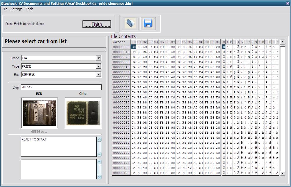

  7. If ECU is SIMTEC 56.xx, immo is stored in flash (29f010) and can be removed using otocheck or immotool.
  8. Try this: clear.rar
  9. My friend, where did you see this engine to do immmo off? Ototcheck and ImmoTool don't have this ecu in database
  10. Try this: clear.rar
