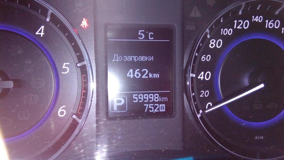

  5. QX70 2012 my. Infinity QX70 59998km 93c76 2012my.rar QX70.txt
