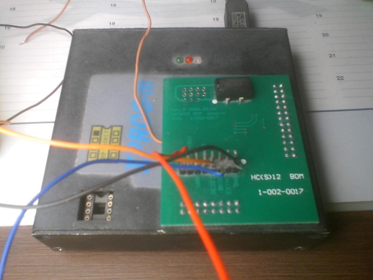

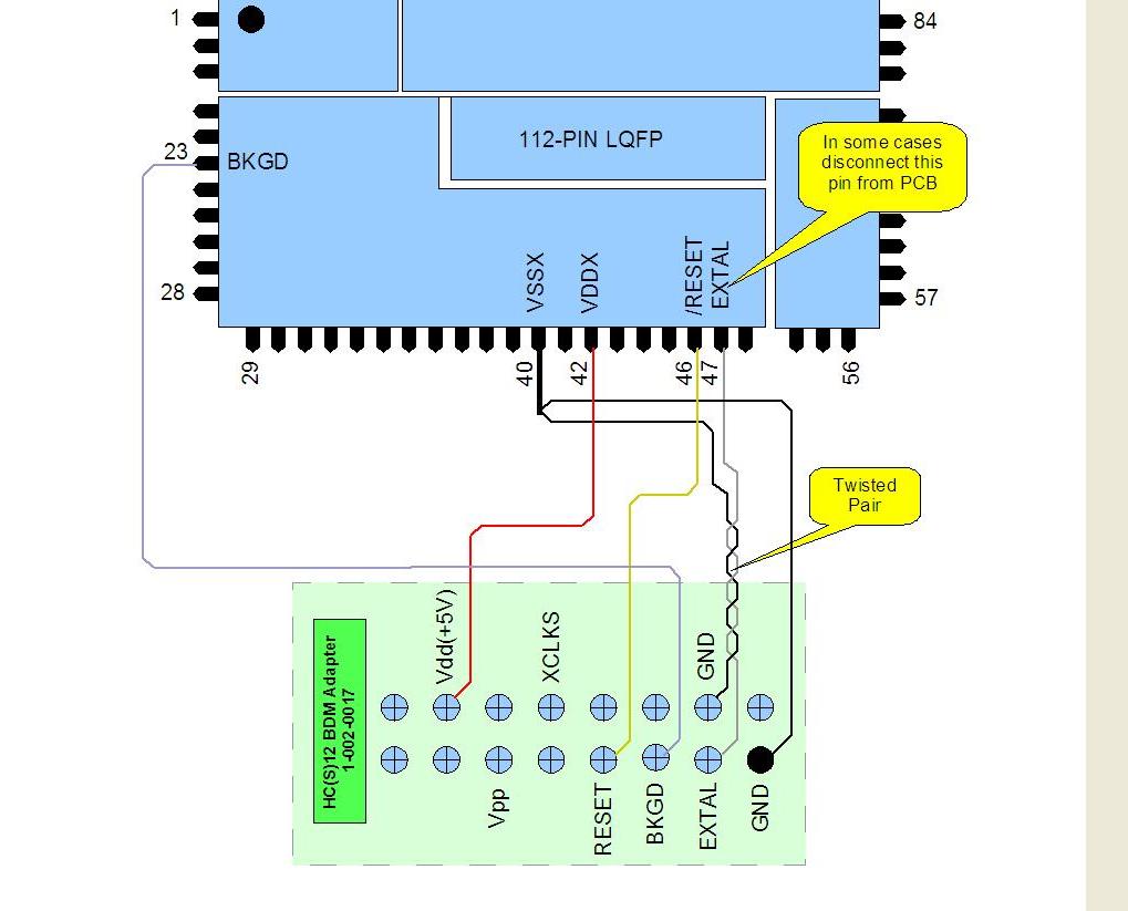

  19. hello and I found this and not get anything read pinout.rar
  20. where is the quartz crystal on this board
  21. I can not read neither R270 nor xprog why?
  22. BDM but since I have not read
  23. and tested with R270 and Xprog not read
