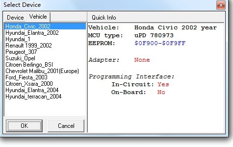

Can someone please help me a bit? I have Alfa Dash with Nec CPU and also I have Nec Programmer, but I can't find ALFA in the list of vehicles:
Is there a picture or some kind of info how can I read/write the Alfa 147 with Nec?

You can see that Alfa 147 exist in the list, but you can not find it in the software.

I have tried today to read the Dash with ETL Nec. Reading is successfull and DUMP is fine, but the KM values on 1st and 2nd line are wrong (around 2,053,193Km). I tried to correct them manualy, then with nyo, then with another calculator and the problem is that I cannot ERASE, MODIFY or WRITE the eeprom. ETL just give me Connection Error at 8x%. It's 8x%, because the eeprom data is starting at address F900 to F9FF. I tried many things to write/modify the eeprom data in the CPU, but with no luck. Is there anything special I must to know? I think that the CPU is write protected or something like that, but can't figure out why and how. Any tips are welcome.
