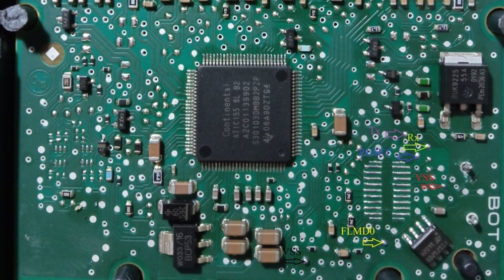

aldr1964 Posted October 5, 2022 Share Posted October 5, 2022 Здравствуйте. Помогите ради бога. чем прочитать ATIC155 12L C3 Link to comment Share on other sites More sharing options...

aldr1964 Posted October 5, 2022 Author Share Posted October 5, 2022 Link to comment Share on other sites More sharing options...
andrei750 Posted October 5, 2022 Share Posted October 5, 2022 блин а что имеется? почему вытягивать надо все Link to comment Share on other sites More sharing options...
aldr1964 Posted October 5, 2022 Author Share Posted October 5, 2022 xprog 5.51 iprog+ (не оригинал но доработанный не подводил) amprog (но это в основном еепром) через два дня получу vvdi prog у меня ощущение что это RH850 renesas, но какая?? Link to comment Share on other sites More sharing options...
море Posted October 5, 2022 Share Posted October 5, 2022 (edited) Может там еепром внешний Edited October 5, 2022 by море Link to comment Share on other sites More sharing options...
aldr1964 Posted October 5, 2022 Author Share Posted October 5, 2022 нету. есть AIS2120d это датчик ускорения. и другая сторона. Link to comment Share on other sites More sharing options...
u-vovchika Posted October 5, 2022 Share Posted October 5, 2022 RH850 там 1 Link to comment Share on other sites More sharing options...
aldr1964 Posted October 5, 2022 Author Share Posted October 5, 2022 Владимир если не ошибаюсь. какая именно?? Link to comment Share on other sites More sharing options...
u-vovchika Posted October 5, 2022 Share Posted October 5, 2022 R7F7010083 Или R7F7010093 Link to comment Share on other sites More sharing options...
u-vovchika Posted October 5, 2022 Share Posted October 5, 2022 1 час назад, aldr1964 сказал: Владимир если не ошибаюсь. какая именно?? Да Link to comment Share on other sites More sharing options...

Basil128 Posted April 27, 2023 Share Posted April 27, 2023 Vvdi prog берёт эти процы? Link to comment Share on other sites More sharing options...
aldr1964 Posted April 28, 2023 Author Share Posted April 28, 2023 17 часов назад, Basil128 сказал: Vvdi prog берёт эти процы? Да. Link to comment Share on other sites More sharing options...
Basil128 Posted April 29, 2023 Share Posted April 29, 2023 А подключение можно такое использовать в vvdi замудреное Link to comment Share on other sites More sharing options...
Basil128 Posted April 29, 2023 Share Posted April 29, 2023 По итогу d flash скачался с ошибкой либо схема не рабочая либо проц выбрал не тот Link to comment Share on other sites More sharing options...
