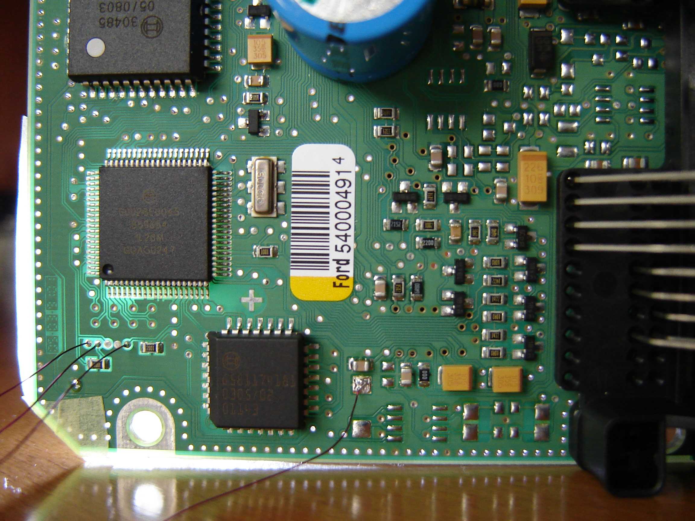

  7. in a meantime a managed to connect with thin wires to the "connector", I did not add solder I only heat-up from one side PCB and from front I put wires in the vias... tomorrow I take it to work on profi programmer.... can anybody confirm what addresses I should fill up with FF?
  8. Thank you, but I am not able to connect directly on microprocessor pins...... Am I too old? :-) for this I took macrophoto of PCB to find connector where also manufacturer connects an dit seems I have found it. Tomorrow I am going to read EEPROM with programmer so I will test it but I wanted to be sure.......

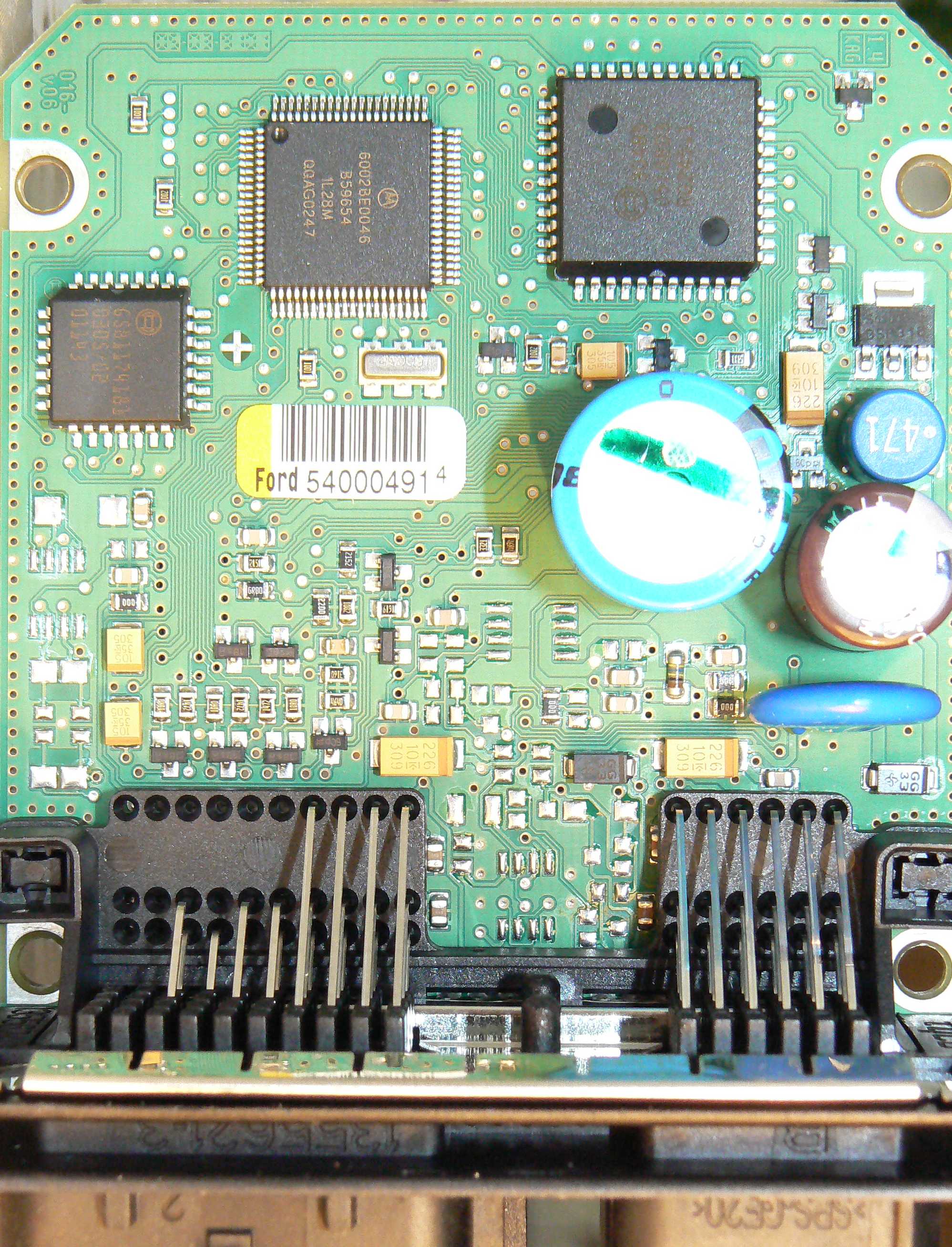

    Hi friends, I could not find any picture of PCB of any airbag computer. So I attach one. I am going to repair it because it exploded already airbag /seat close to driver/ Another picture shows places where programmer can be connected. I found these by watching PCB routes and measuring resistances. It seems that +5V for programmer has got 1Ohm resistance in series so it can only be used to inform programmer about +5V ? Can anybody please confirm that connector is correctly identified? /BKGD, GND, VFP, +5, RESET/ Please, if anybody knows what should I delete in EEPROM can write it over here? I mean space in EEPROM from 0x??? to 0x??? must be filled with FF. Thank you for the help! I hope my photos will be usefull!
