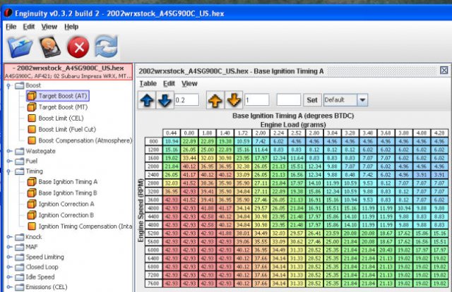

Enginuity is a free Engine Control Unit (ECU) editor used for tuning Fuel, Timing, Boost and all other ECU controlled parameters by virtual any vehicle manufacturer
Enginuity provides many features normally only seen in commercial software applications. The main capabilities are:
Platform agnostic: Enginuity is written in Java making it easier to support tuning on various operating systems. Currently Windows and Linux are supported.
Subaru and Mitsubishi support: Support for many Subaru and Mitsubiti ROM versions via plug-in ECU definition data files. ECU definitions can be upgraded independantly of the actual tuning software.
Multiple maps: The ability to load, modify and save one or more ROM files
Intuitive user interface: Simple, easy to use user interface which presents the various ROM maps within a tree view grouped by function e.g. Boost, Fuel, Timing are each groups collating a number of related maps.
Tuning by User Level: This is a tuning safety related capability which restricts (write) access to certain maps based on User Level e.g. beginner, intermediate, advanced. User level may be dynamically switched at any time.
Intelligent map data display: All data within maps are intelligently displayed using the appropriate unit of measure e.g. RPM, Boost (PSI/Bar - absolute or relative), Temperature (degrees F or C). Additionally map data is colour coded greatly reducing the time taken to understand and tune a map.
3D graphing: Map table data may be displayed in 3D as an additional map visualisation aid.
Map tuning assistant: A detailed description of each map is available to the tuner from the map properties page.
Map comparision: This allows maps from the same or different ECUs to be easily compared.
Map copy & paste: ROMs can be quickly tuned using the map copy and paste capability.
Map smoothing: This allows tuners to interpolate map data values greatly reducing the time taken to alter maps.
Realtime data logging and post analysis tool: This includes the ability to overlay data logs on to actual maps as an aid when fine tuning.

вот прошивка от субарика, открой в этой проге и посмотри, сразу станет понятно
STG1 MY05 LGT MT rev1.rar
Изменено пользователем o717ka
Вот теперь пацаны для меня всё понятно, по человечески,...и без всяких ...обид. Спасибо.
в проге даже маска ошибок есть, и основные калибры ( около100 ) :post-7:

Вот считал файл калибровок Галетой. Вопрос можно ли этой прогой Enginuity редактироать этот файл.
  • 3 месяца спустя...
Аналогичная ситуация по галлете. Просветите кто в курсе. Чем можно калибры из Галеты править ?
Да и по проге, это вроде бета как я понял. Где deffenition файлы брать?
