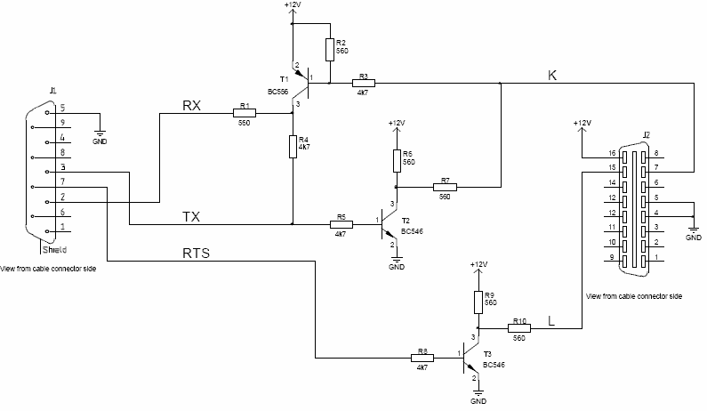

2-i was going to make an L-line adabter like the one in the attached picture to connect the ECU to my computer
3-i know that, but do i have to open my ECU and add the two 5 K ohm resistors like the second picture or can i read and flash my ECU without opening it?

read with your adapter using two resistors like in your photo. If you can read this software, I'll try to help you.
