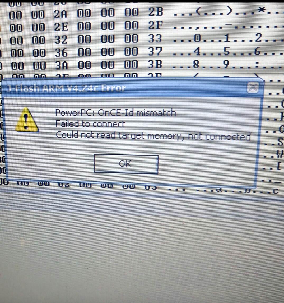

 - WARNING: Unexpected core ID. (Found: 0x00000000, Expected: 0x07E0E01D, Mask: 0xFFFFFFFF)
 - Connected successfully
