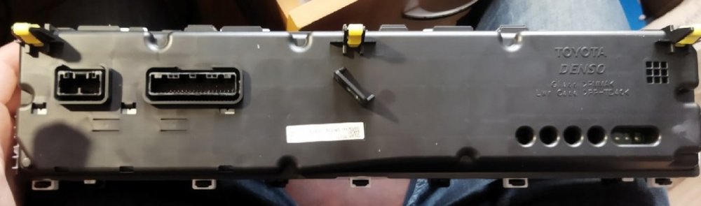

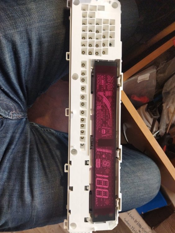

November 22, 20214 yr comment_1257500 Подскажите как разбирается панель от Аква 2016? Дисплей обязательно надо сдергивать ? Link to comment https://www.auto-bk.ru/forum/topic/99133-toyota-aqua/ Share on other sites Share on Facebook Share on X Share on Pinterest More sharing options... Share this post
November 22, 20214 yr comment_1257501 смотря каких целей Link to comment https://www.auto-bk.ru/forum/topic/99133-toyota-aqua/#findComment-1257501 Share on other sites Share on Facebook Share on X Share on Pinterest More sharing options... Share this post
November 22, 20214 yr comment_1257503 Делается без разбора по пятакам... Link to comment https://www.auto-bk.ru/forum/topic/99133-toyota-aqua/#findComment-1257503 Share on other sites Share on Facebook Share on X Share on Pinterest More sharing options... Share this post
November 22, 20214 yr comment_1257504 отверткой ? Link to comment https://www.auto-bk.ru/forum/topic/99133-toyota-aqua/#findComment-1257504 Share on other sites Share on Facebook Share on X Share on Pinterest More sharing options... Share this post
November 22, 20214 yr Author comment_1257505 34 минуты назад, goga200077 сказал: смотря каких целей смотать Link to comment https://www.auto-bk.ru/forum/topic/99133-toyota-aqua/#findComment-1257505 Share on other sites Share on Facebook Share on X Share on Pinterest More sharing options... Share this post
November 22, 20214 yr comment_1257506 так снимай заднюю крышку ... в чем проблема !? Link to comment https://www.auto-bk.ru/forum/topic/99133-toyota-aqua/#findComment-1257506 Share on other sites Share on Facebook Share on X Share on Pinterest More sharing options... Share this post
November 22, 20214 yr Author comment_1257507 она не снимается, она на болтах, и самое печальное что часть болтов (3шт) находяться под дисплеем. Link to comment https://www.auto-bk.ru/forum/topic/99133-toyota-aqua/#findComment-1257507 Share on other sites Share on Facebook Share on X Share on Pinterest More sharing options... Share this post
November 22, 20214 yr comment_1257509 ну сквозь дисплей саморезы ТОЧНО не открутить 🙂 Link to comment https://www.auto-bk.ru/forum/topic/99133-toyota-aqua/#findComment-1257509 Share on other sites Share on Facebook Share on X Share on Pinterest More sharing options... Share this post

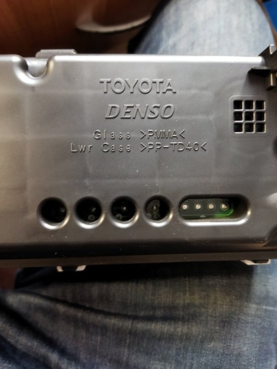

November 22, 20214 yr comment_1257510 Приходилось делать такую , две машины были , там действительно два самореза закручены под дисплеем хоть дисплей и толстый и мощный вытащить его не получилось ! там всё просто , открути все видимые саморезы и отгибай заднюю крышку не бойся вкрученные саморезы легко отломаются ! и увидишь 93с66 мсоп делается внутрисхемно без проблем ! Link to comment https://www.auto-bk.ru/forum/topic/99133-toyota-aqua/#findComment-1257510 Share on other sites Share on Facebook Share on X Share on Pinterest More sharing options... Share this post
November 22, 20214 yr comment_1257511 Вот и дамп нашел Toyota Aqua.126378км.с66_16г.мсоп.bin Link to comment https://www.auto-bk.ru/forum/topic/99133-toyota-aqua/#findComment-1257511 Share on other sites Share on Facebook Share on X Share on Pinterest More sharing options... Share this post
November 23, 20214 yr comment_1257519 Аккуратно отгибаешь по очереди белые фиксаторы и одновременно тянешь вверх эту часть дисплея. Постепенно дисплей высвободится. Так же и собираем. Отламывать это как то по варварски. Link to comment https://www.auto-bk.ru/forum/topic/99133-toyota-aqua/#findComment-1257519 Share on other sites Share on Facebook Share on X Share on Pinterest More sharing options... Share this post
November 23, 20214 yr Author comment_1257521 Ну выламывать мне тоже показалось по варварски, но дисплей показался сильно хрупким, массивный и стеклянный чуть на перекос пойдет и лопнет , как мне показалось Link to comment https://www.auto-bk.ru/forum/topic/99133-toyota-aqua/#findComment-1257521 Share on other sites Share on Facebook Share on X Share on Pinterest More sharing options... Share this post
November 23, 20214 yr comment_1257528 Хотите сломать дисплей , ломайте ! дисплей очень туго сидит и вытащить его практически не возможно , а то что два самореза отломаются их видно не будет и в задней крышке тоже ничего не видно там саморезов и так достаточно ! на двух машинах пытался дисплей вытащить но он в разъёме очень туго сидит ! пробуйте потом расскажите как у вас получилось и если не трудно фото сделайте , дамп нашел , а фото которые делал найти не могу Edited November 23, 20214 yr by sergeiii Link to comment https://www.auto-bk.ru/forum/topic/99133-toyota-aqua/#findComment-1257528 Share on other sites Share on Facebook Share on X Share on Pinterest More sharing options... Share this post
November 23, 20214 yr comment_1257534 Я снимал дисплей без проблем лопаткой пластиковой Link to comment https://www.auto-bk.ru/forum/topic/99133-toyota-aqua/#findComment-1257534 Share on other sites Share on Facebook Share on X Share on Pinterest More sharing options... Share this post

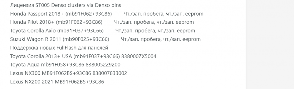

November 23, 20214 yr comment_1257579 А кто его исследовал что бы в список добавить ? Link to comment https://www.auto-bk.ru/forum/topic/99133-toyota-aqua/#findComment-1257579 Share on other sites Share on Facebook Share on X Share on Pinterest More sharing options... Share this post
November 23, 20214 yr comment_1257583 Только что смотрел нет там такой модели ! Link to comment https://www.auto-bk.ru/forum/topic/99133-toyota-aqua/#findComment-1257583 Share on other sites Share on Facebook Share on X Share on Pinterest More sharing options... Share this post
November 23, 20214 yr comment_1257585 Нашел в с туле но там с86 Link to comment https://www.auto-bk.ru/forum/topic/99133-toyota-aqua/#findComment-1257585 Share on other sites Share on Facebook Share on X Share on Pinterest More sharing options... Share this post
November 23, 20214 yr comment_1257593 Да.да.... точно есть... Link to comment https://www.auto-bk.ru/forum/topic/99133-toyota-aqua/#findComment-1257593 Share on other sites Share on Facebook Share on X Share on Pinterest More sharing options... Share this post
November 24, 20214 yr comment_1257602 Да в Стуле есть.Причём не только эта панелька. Link to comment https://www.auto-bk.ru/forum/topic/99133-toyota-aqua/#findComment-1257602 Share on other sites Share on Facebook Share on X Share on Pinterest More sharing options... Share this post
