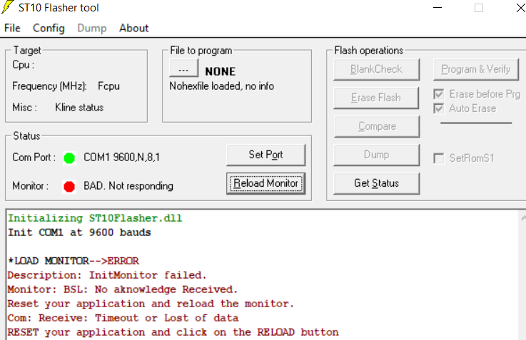

September 1Sep 1 comment_1311909 ST10Flasher 2.4B Edited September 1Sep 1 by cxem Link to comment https://www.auto-bk.ru/forum/topic/105908-%D0%BF%D1%80%D0%BE%D1%88%D0%B8%D0%B2%D0%BA%D0%B0-%D0%BC73-%D0%B0%D0%B2%D1%82%D1%8D%D0%BB/#findComment-1311909 Share on other sites Share on Facebook Share on X Share on Pinterest More sharing options... Share this post
September 1Sep 1 comment_1311910 Не возъмёт это, закрытый автэл... 90% Link to comment https://www.auto-bk.ru/forum/topic/105908-%D0%BF%D1%80%D0%BE%D1%88%D0%B8%D0%B2%D0%BA%D0%B0-%D0%BC73-%D0%B0%D0%B2%D1%82%D1%8D%D0%BB/#findComment-1311910 Share on other sites Share on Facebook Share on X Share on Pinterest More sharing options... Share this post
