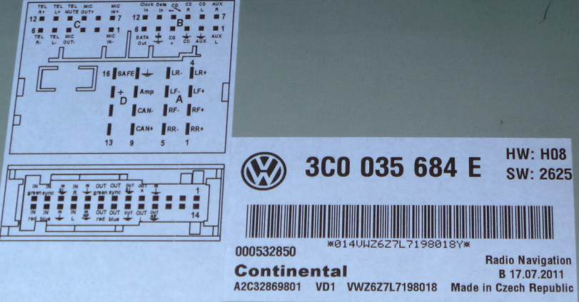

here is pinout of RNS510 old and new version...
cuby

I have found this (regarding carprog adapter) true or false..can somebody confirm??
Hi ,
someone can confirm this .
On the aux 26pin connector :
1 – Reserved for Debug RX protocol(Tx from carprog)
2 – Reserved for Debug TX protocol(Rx from carprog)
We need the GND connected also ?
Multi-pin connector 2
12 – Voltage supply, negative, terminal 31
15 – Voltage supply, positive, terminal 30
So to resume in the cable there is just Rx Tx lines and we need to supply the 12V to the radio .
Someone used the carprog with this radio and can confirm the cable schema ?
Thanks
cuby
