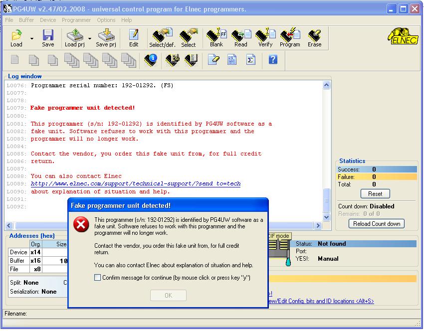

vladan064 Posted August 28, 2008 Share Posted August 28, 2008 I am sorry becouse I write on english, I very well understud russian and read but I am not good to write. i buy BeeProg programmer as original on paper advertisment, it's look like original but it clone, and it was work perfectly until I wasn't install new version of elnec sw, after that pic was erased. Does somebody have dump for pic inside BeeProg? Best regards, Vlada 4 Link to comment Share on other sites More sharing options...
leschyj Posted September 17, 2008 Share Posted September 17, 2008 Hello, If you see message Fake programmer unit detected it means that you bougt your Elnec Beeprog with good price for fix this problem you should: 1. Unistal Elnec soft 2. Delete Elnec folder from Programm files 3. Restart PC 4. Instal Elnec soft 2v41 or - 5. Dissasamble Beeprog 6. Reprogramm MCU 7. Assemble Beeprog >>6. is problem, because MCU have secure. Code extraxtion cost ~2000eur or more I know man who have this code but he do reprogramm by him self or send peoples programmed MCU. If I good remeber it charge 100eur I am sorry becouse I write on english, I very well understud russian and read but I am not good to write. i buy BeeProg programmer as original on paper advertisment, it's look like original but it clone, and it was work perfectly until I wasn't install new version of elnec sw, after that pic was erased. Does somebody have dump for pic inside BeeProg? Best regards, Vlada Link to comment Share on other sites More sharing options...

drieg Posted April 11, 2010 Share Posted April 11, 2010 !!! IMPORTANT TO ALL NON-ORIGINAL BEEPROG USERS !!! Do not update to version v2.68 of ELNEC control software! It will kill your BeeProg programmer made in China - see my page for details: http://drieg.comxa.com/beeprog.html The latest "safe" version is 2.67 (available on my page). Be careful, or you'll end up with "Fake programmer unit detected!" message and dead programmer! Link to comment Share on other sites More sharing options...
